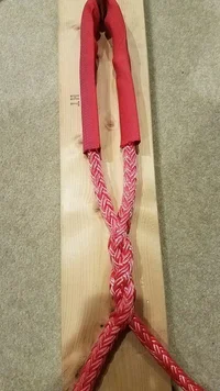

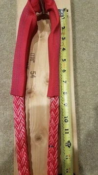

Started by finding the middle, sliding a nylon sleeve to the center, and measuring down 12" for first loop:

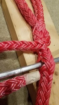

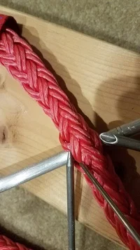

Stuck a fid through making sure I had 3 right twist strands and 3 left twist strands on either side of the fid with no stray yarns separated by the fid.

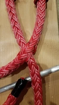

I taped one end with masking tape and one end with electrical tape to make it easy to keep track of "black" and "white" ends. Pushed white end through first:
Then the black end:

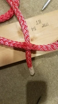

And the white end again to finish off the first loop:
And tightened everything up:

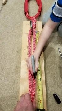

My helper measured and marked for the next loop:

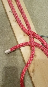

This time I started with the black end:
Then, of course, the white;

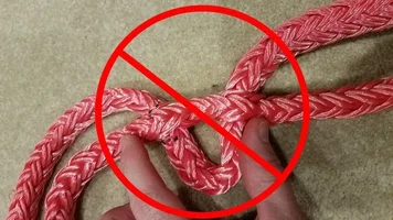

I say "of course", but as I was finishing loop #4 with "white", I realized I messed up somewhere... Loop #3 got white fed in for the first two, then black for the 3rd which led to #4 starting and finishing with white. Pulled out loop #4's splices and the 2nd and 3rd in loop #3. Lesson learned (thankfully caught early!)...don't be so distracted:

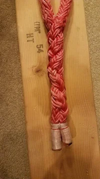

What I did was to run locking brummels until I didn't have rope to do another (used 5). Part of my thinking is: "If it is good for the goose on the first 11 pockets, its good for the gander on the last!" Right?????
I don't expect there is any less strength from this last spice (even if only 3 like the rest). As long as the ends won't back out, I'm thinking I have the strength. I finished off each end with some whipping twine and shrink tubing. I ran some lock stitches to hold the 2 ends together, then "lashed" the 2 ends with more whipping twine. They aren't moving. If we see them start to pull in use, we'll just have to abandon the last loop and redo that end with a bury after the last brummel and lose the #12 pocket.
