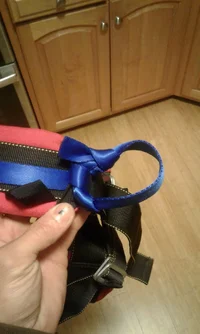

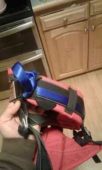

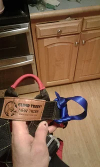

My kid stared off with a kids rock climbing harness, I wanted him to have d rings. I took a 5/16 ths nylon loop runner and two SMC rappel rings girthed to it with a few stitches to make sure it wouldn't shake loose. I'll see if I can dig up some photos tomorrow.
Are you planning on using these soft Dee's for primary life support while transferring, or just positioning?
That's really a cool idea, and it looks bomber, but I'm really more curious about that thumb tattoo.
Also, just thought I'd throw it out there because I have thought about this some, but while everything may be bomber that you make, please remember that when you're making things for people who aren't pros you have to remember that they don't have the habits of checking everything every time or really understand the forces at play. I like the rings better just because you can't clip into the ring wrong. Y'all make sure everyone is safe and have fun.

Red one in first post is the new tribe twist. Which I would recommend for the six year old.
They make the kids basic with side d's as well which I would recommend for the ten year old.
Both are great harnesses. My boy just graduated to the basic and he is really stoked on it.
I got 17 stitches in that thumb.. The ER doc who sewed me up was stoked that he could like up the tissue by using the tattoo... Truth to be told, my kid isn't allowed to rope climb unless I'm in the tree with him.
At no point will my six year old be unsupervised climbing trees. I believe your concern is slightly reactionary.
Well of course your six year old won't be unsupervised.
It was just some of my thoughts in general when modifying gear for non-climbers.
I may have thrown it out in a little bit of a reactionary manner, but it came up recently and I felt like sharing.
My wife recently got her first harness and I realized when I was thinking about adding a caritool that it should be somewhere distinctly different from her side D because of the lack of habits I mentioned above.

2) I made a similar mod when climbing in a rock harness, but my biggest complaint was the rings shifting, so I wanted to add a note for anyone trying this mod to keep in mind that you need to always clip in to both at the same time unless you've made accommodations for that.
