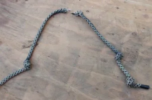

Here is the broken Beeline Bridge. I think it was 9mm.

Have you been using it?
I tested this rope a while back:
8mm Beeline
I haven't used my hitch cord much, so I don't know what the cord looks like when it is well worn, but it seems like there should have been some visible sign that the bridge was getting weak. Even if the core was severed the cover would still have plenty of strength, and it is visible, and the wear should be evident. Something doesn't add up...
Jamin's pic has nothing to do with tensile strength. It has everything to do with the self abrasive quality of technora.
Your powers of perception far exceed mine; I can't look at one blurry picture of a broken rope and declare that I know why it broke.
In the picture it appears that both the core and the cover broke at the same spot. Since both cover and core are made from different materials, and both are very strong, and the forces on the bridge are presumably very low, and the vectran core has tremendous flex-fatigue resistance and abrasion resistance, it seems highly peculiar that both parts of the rope gave up the ghost at the same spot at the same moment.
Technora and vectran are very similar fibers. Technora is a little more slick thus slightly less self abrasive. Bee line 8mm has a vectran core and a 75%/25% technora/polyester cover. Based on what is known about these fibers and aramid bridge failures it is a safe assumption that the bridge failed due to the self abrasive nature of the fibers. What do you think happened?

I don't think it's a totally wrong idea to use the Beeline for short periods of time. That's sort of my warning.
Ordinary polyester fibers are not particularly slick; do you therefore think they must be much more self-abrasive than Technora or Vectran? Why do you think self-abrasion has something to do with slickness? And can you cite a reference indicating, as you claim, that Technora is less self-abrasive than Vectran?
Technora and Vectran actually belong to two distinct classes of polymer: the first is a polyamide (aramid) and the second is a liquid crystal form of polyester. Whether or not they are "very similar fibers" depends on what particular property you are considering. Here we are speculating about a bridge failure which may or may not have something to do with similarities or differences between the two fibers.
Since only one of the three fibers is an aramid, it seems quite a leap to classify this as an "aramid bridge failure" or to assert it is a "safe assumption" that the failure was due to fiber self-abrasion. Were the non-aramid fibers self-abrading right along with the aramid ones?
I frankly don't know what happened. If we could actually inspect the broken bridge we might have a better idea. An interview with the bridge owner would also be helpful. Without more information, I would have no idea how to come up with any sort of assumption about what happened, let along a safe one.
I meant to say vectran is more slick therefore less abrasive. I was posting from my phone. My source is Tom from All Gear. I talked to him about it at TCIA expo.
It appears as though a sharp object was involved. I haven't seen fibers pull apart like that. There are usually more 'short and long' fibers in a "pull", as opposed to a cut.
Is it possible to take a close-up image with a clearer focus?
Good question Norm. We don't have that cord anymore. It was tossed.
I took a long look at it and it didn't look cut. I'd say there were a fair amount of long and short fibers, like a pull would show.
