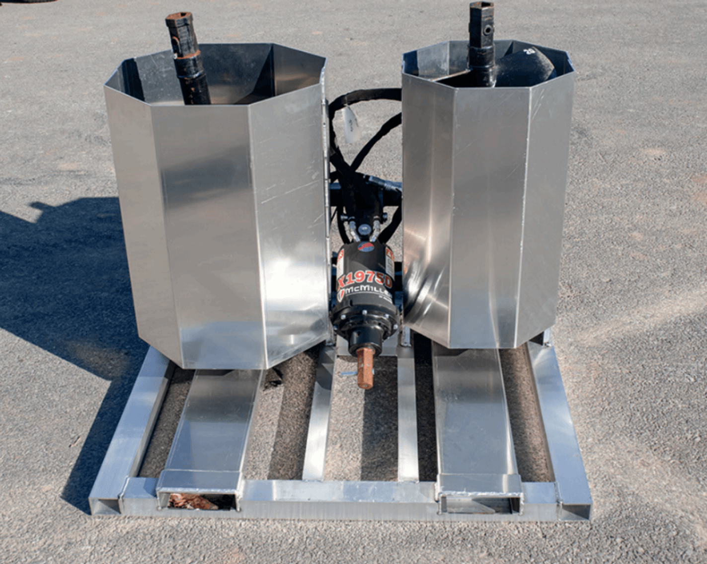

One of our biggest suppliers recently started selling these:
I can't find a link to them other than to a couple they sold at a recent auction they hosted, but you can get an idea of what they look like. Seems like one of these set up for your preferred auger sizes might be the ticket, especially since you can move the whole contraption around with the quick attach built into it.

Yes...for planting. I'll likely do as you say and keep the auger on the machine and forks separate. It's how to store it at the shop.
I was thinking along those lines with a heavy pipe to put the drive unit into that and hold it upright.
Maybe something more like this for the bits...but not quite.
I have a 40" diameter x 18" depth (28" overall length) and a 24" diameter x 36" depth so they won't quite store on that exact rack. (will probably also get one to do post holes...not that I want to do fences, but to it seems to make sense to buy the bit since I've got a drive unit)
