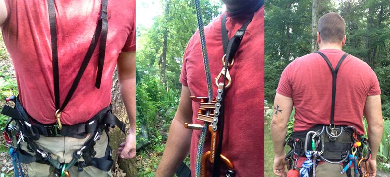

Member
i have suspenders and simply use a keychain biner off of my suspenders.
Derrick
I thought everyone from PA had suspenders?
