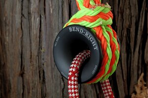

I was under the impression that one must have two adjacent rings when using it for a primary rigging point in negative rigging. I’ve seen lots of footage with people only using a single ring. Are there any threads I can be directed to or anyone who can weigh-in?
Also, any reasons why people don’t like ultra slings with rings for primary rigging point?

On the technical side, having 2 rings (or the bendright rings) ensures the proper bend radius ratio for the rope. If I’m not mistaken, I believe the bend radius for rigging should be 1:6 (someone if very welcome to correct me here).The bend radius needs to be 6 times the diameter of the rope. So, 1/2” rope, 3” bend radius. Rope manufacturers should give the recommended radius and ratio for their ropes.
One ring tends put ropes in a tighter bend, which gets more troublesome when you’re blocking down big wood.
I don't see the literal radius being different, just that the two bends have a short, horizontal run between them.
This is the point that I couldn't grok out of thus, but the nagging voice in my head kept saying something isn't correct! I have done some experiments with swivels, exploring this concept, and I think that you're correct here Sean.
Two rings in no way creates better bend radius..just more surface area. A tad better than one with more surface area, but lets not fool ourselves into thinking bend radius increases.
Thats where that 3rd small ring in the center comes in. It adds the bend in the middle so it is an actual improvement to the bed radius not just a longer horizontal run to the edges where the bend radius actually lives.
