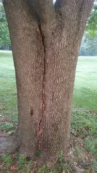

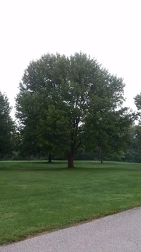

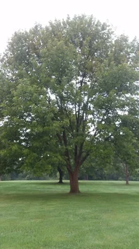

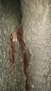

So for those of you who do not know I am currently only a part timer when it comes to working with trees. The other day I showed up to my day job and saw this Ash tree near the entrance of our facility. I have not done any previous cabling, but have very basic knowledge from reading and I like to think I have common sense. So I believe I could take this on without necessarily a proper training, but feel free to let me know if I am in over my head or if this tree is in fact not a good option for cabling. From my understanding any cabling should be accompanied by trimming the tree to reduce the weight at the tips of the branch and cables should be located about 2/3 the height of the tree.
My questions are, is cabling species specific and if so is Ash an acceptable species? Where I live we are just starting to encounter EAB, is this tree worth the effort to try and save if we get it treated as well? Is the length of this split an issue? It is roughly 6 feet long and is technically a codom that grew together.
If there's anything I missed feel free to ask.
Thanks in advance,
Justin

I can't answer your ash specific questions.
I'd say go for it, it appears that there aren't any fixed targets, so the goal would be just keeping the tree whole. This tree would need steel cable and atleast two bolts or through rods installed in the crotch. Pick up the ISA best management booklet on cabling and bracing.
Give the home owner a break on the price, charge only for materials and use the tree as practice. There is a learning curve when it comes to this stuff, and it will take much longer than you expect.
FYI the specs are 2/3 FROM the defect to the top. Not 2/3rds the total height, even though in the case above it's basically the height.
How tall is the tree? DBH? And diameter of each stem?

Thanks for the info, it is much appreciated. In this case there is no homeowner, I work as the facility manager at a state hospital where this tree is located, so I will be providing the labor as part of my salaried job. Can't give much more of a break than that ;)
I was also curious about that 2/3 measurment, that is good to know.
The tree is probably 35 feet tall, dbh is 30" diameter of the stems is maybe 12" each (I hadn't measured that)
You mentioned steel cable, is the cable stops the preferred way to attach the cable? I know there are lag bolts but I believe I've seen mixed opinions on them.

Let me give you the tl:dr up front: this tree is not worth the effort you'd have to put into it, unless there is a compelling aesthetic or sentimental factor. You may want to consider doing it anyway, for the learning experience.
To hold that tree together, you would need to reduce it, cable it, and brace it. It sounds like you have a pretty good handle on reducing and cabling. You're correct, the standard calls for cabling to always be preceded by reduction, although that is, I've found, frequently ignored (reduction is difficult and time consuming...who wants to do that :) There are no specific mentions of species in the standard that I recall, but common sense dictates that it should be considered in your specification. For example, you would probably install a through bolt rather than a lag in a poor compartmentalizer. As an aside, I don't like lags, full stop. There are also structural considerations, like not cabling between the interior branches of two unions, but that is largely dictated by what's on offer in the tree. A small correction: the cable should be placed 2/3s the height of the union being supported, which is only 2/3s the height of the tree if you are supporting a union at ground level.
In a union that has already split, like this one, bracing is called for. Basically, one or more threaded rods are installed at and just below the split with a washer and two bolts at either end, to pull it back together. Even at ground level, this is very difficult and time consuming; you'll need a bit of the appropriate diameter that is long enough to go all the way through the tree. Those bits are expensive, and you'll need a drill with enough huevos to drive that bit all the way through. Your tree looks like it needs at least 4 or 5 brace rods, and that lowest union is pretty girthy. Bracing never goes smoothly, and it's very difficult to estimate.
If EAB is in your area, and the tree is not being treated, this is probably a waste. In the end, it boils down to 1)who is paying, and 2)what is that party's expectation. If it's a customer, I would lead with removal and replacement; that split is really bad...but if they really want to retain the tree, for whatever reason, they really have to treat for EAB, reduce, cable, and brace...and it's still not a sure thing; make sure your legalise reflects that reality and that the customer understands that this thing could still fall apart/be consumed by insects/be abducted by aliens, etc. Manage the hell out of their expectations, and get a John Hancock to that effect.
If you are doing this for yourself, the considerations are the same, except you can offset the cost with the experience you'll get out of it, and the new equipment you'll have afterwards. You sound like your head is on straight, so none the the individual steps should be beyond you, just remember that you need to do a lot of cabling to make it worth your money in the equipment investment. Make sure you get a copy of the best management practices for A300 part 3 - supplemental support systems. It is cheap, has good info, and will help you right-size the components you need.
Sent from my XT1650 using Tapatalk
fall_risk
Well-Known Member
Philadelphia
Cable stops, amon eyes, or through bolts are all totally appropriate. In my mind, the only excuse for using a lag is when the girth of one or both of the stems being cabled is so great that it's not economical for the customer to drill all the way through, we're talking 24+inches here. I feel the use of lags should be disclosed to the customer. There is usually a creative solution for a longer cable to avoid the use of lags.

The tree is not anymore special than any other tree. In fact this is simply one of 24+ other Ash trees on our property as well as many oaks, Hackberry, maples and others on the 18 acres that we maintain.
As for the owner, that is technically the State of Indiana (believe me, the government has spent more money on bigger lost causes) but for all intents and purposes I am the owner until I choose to retire.
It is my job to upkeep the health and well being of both the buildings and grounds so I will remember that this tree has been cabled and will inspect it.
Now it still may be the best advice to remove it or wait until mother nature finishes the job herself and then plant another tree. That is part of the question that I originally asked and with the exception of the tools and experience gained, it is probably the most logical option.

Rope or dynamic cables allow for movement, which is good when there is not a defect that needs to be addressed, crack or included bark.
The tree in the photo has a crack, and certainly included bark. Basically any time you need or question the need if bracing in a tree a steel cabling system should/shall be used.
As far as hardware choices I never have considered lags. Only through bolts, or threaded rod with Amon eyes, or rig guy wire stops. I second Tom's statement with the 2/3rds rule. Trees are not engineered structures, and every one calls for something different. I've gone any where from half to 90%.
