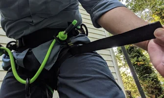

So that brings me to the matter at hand: I've purchased a Notch Sentinel harness to finally replace the rock harness I've been using. With that said, I think it probably needs to go back - but since this is my first harness, I wanted some advice: Is this operator error, and some adjustment would go a long way? Or does this harness just not fit me? Please see attached images:
I had seen several reviews where people complained that the leg loops were too big. I'd also read some reviews where people who were on the limit (size 1 ends at 36, size 2 starts at 36) had issues with it. I'm around a 36 - but this might just work for me - right? I purchased a size 1 because I wasn't sure if that size 36 corresponded to pants size or if you wear a 36 pants, this would fit on top of all that. Hint: it's closer to pants size. I also noted the reviews about the huge leg loops and was afraid that if I got a size 2, i'd be drowning in the rest (or I wouldn't be able to tighten the harness enough).
So... if you look at the photo where i'm holding the strap. That's the excess strap for the leg loop. It's hard to see, but if I had my arm bent more, my elbow would touch the strap an inch or two away from the buckle. I've only got about 2 inches left in the adjustment.... and I'm on the max end of the size scale for this harness. And my thighs are not small.
If you can see in that picture that I have about an inch of webbing pulled on the waist belt. That buckle is a b*tch. Seriously. Because you have to hold the parts away from you push them through at an angle, then it loosens when it latches - and it's a bear to tighten once it's latched. But probably not such a big deal if the strap was long enough to grab onto (again, I'm at the MAX of this size).
So I got the thing on, it's generally adjusted close to where I'd have my climbing harness... here's where I need some help.
1) Is the waist belt seem to be positioned right? I feel like it'd be more comfortable if I could get it over my pants belt and shove it a little lower around my hips, but of course there's nothing to keep it from sliding up (besides the fat bunching up above it).
2) leg loops seem about right? This is the most comfortable I could get them - but the elastic between the legs and waist belt was maxed out and pulling them into my junk every chance they got.
3) I wonder if being at the max size means the waist belt isn't wrapping around far enough to the front. So when I hang on it, instead of pulling more to the front, it's really crushing that front section of the harness into me. I don't have a huge gut, i'm pretty uniformly distributed with a nice thick layer of cold-weather protection. Anyway, that place right there where my fat is bulging into my shirt is actually my fat bunching up and getting pinched between my harness and my ribcage.
4)Is it normal for the belt to tweak like that? See there's a pretty big gap at the top of the rearmost section that doesn't even touch my body. My back is particularly flat there though while most people's curve inward - so that might be part of it.
Finally: I'm leaning towards this harness isn't a good fit. I don't think sizing up is the answer, because I'm already running out of room on the legs to tighten them, I would imagine if they were bigger they wouldn't fit. I'm also worried that I'll have the belt on the size 2 cinched completely tight and be really pushing it. Also, it's not nearly as neon green as it looks on the website pictures. it's more of a green green.
This harness was really a little more than I wanted to pay considering it's not what I do for a living - but I didn't want to go too basic or old-school either. I'd like to have at least side D's to get stuff off the center, and somewhere to put some gear. Some other saddles which I'm not on the edge of a size:

Dumpy, first, don't attach much value or significance to anything I say, because I am not a professional and have limited experience with harnesses. Plus I am biased in favor of a bosun seat and have never found a harness with separate leg pads to be anywhere near as comfortable. From the beginning, I have been using a Sherrill Tree Edge harness with a bosun seat which, unfortunately, is not available anymore, and I don't see anyone else making a bosun seat harness these days. I don't understand why everyone does not prefer a bosun seat, but that is a subject for another thread. That said, I have the Sentinel for a backup, and I have used the Onyx for a short term as well.
The Onyx was my first experience with a harness with separate leg pads, and even after spending a lot of time getting it adjusted, I always felt like I had a tourniquet around both legs, and I hated the constant crotch crushing. But over time, I also learned that there is a huge mental component to what we call "comfortable" in a harness. It's a relative term. We have a remarkable ability to adapt, and when I lowered my expectations of what it meant to be comfortable in a harness, the Onyx felt better. Each time I used, it got better, not because it fit any better, but because my expectations changed and I adapted. I still eventually sold it, but I learned something valuable about it. Later, when I got the Sentinel, my expectations were already low, so I managed to adapt to it pretty well and kept it.
I agree that the Sentinel's elastic straps that hold the leg pads in place are too short and hold the pads up too high. It's hard to tell from the picture, but it does appear to me that you are wearing the waist belt too high. Lowering it a bit should solve a lot of problems. It will help make up for those too-short leg pad straps, and the waist belt should not be jamming into your rib cage.
I also agree that the buckles are a bit awkward and annoying at first, but they do work and in time you will adapt. Other than all that, I don't have much to offer except to suggest that you give it some time to see if you adapt to it. I think the Sentinel was a good, reasonable choice considering your situation, but if you decide this is not the harness for you, then sell it and try something else. I imagine most here would suggest the TreeMotion Light for your next try.

Hey, Dumpy!
Color- they just changed the color scheme, but haven’t updated the photos.
Buckles- the buckles work much better with excess strap available;so yes, your main buckle issue is the saddle’s size.
Waist- size two would be a much better fit.
Leg fit- normally, you don’t want your leg straps to be tight on your thigh, so the added room of the size 2 shouldn’t be a problem.
Overall- saddles come down to adjustment (and sizing). There are threads that go over the adjustments for different saddles, but most of them work the same way-
• leg loop pad should be just above the back of your knee.
• leg loop doesn’t need to be tight, but shouldn’t be loose enough to fit your fist beside your thigh when buckled.
• waist belt should sit just above or resting on your hip bones
Personally, I like a larger size to bring the side Ds forward from my hip bones.

Thanks for the input @misfit and @Crimsonking~
There's no way to get that waist belt lower and over my pants and belt unless I up a size. Leg loops behind my knee is never going to happen with those elastic things. I wondered about how loose they should be, because i figure if you're sitting in it like you would a swing (or a bosun seat for that matter), it doesn't have to be cinched down.
as for lowering my expectations - I just want to point out I'm coming from a rock climbing harness... While I definitely had the expectation this should be night and day different - at the moment and the way it's set up now, I can't say it's not better - but it's definitely not $400 better.
I think based on the input so far, a larger size might alleviate a lot of my issues. I really think the attachment point feels too far around my side and not forward enough. I'd like to see if there's any other advice, and try to re-adjust and re-hang to see if I can at least get the legs good. I think it might be worth it to look into a saddle where I'm not so close to the extremes of the size range though.
