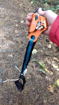

I made this to be like a saka, but I wanted to be able to use all the holes easily, which is why it's not sewn tightly. I might add some velcro on the back though, there is quite a bit of slop right now.
Unfortunately the color doesn't look as good as in the pic anymore...

I made this to be like a saka, but I wanted to be able to use all the joles easily, which is why it's not sewn tightly. I might add some velcro on the back though, there is quite a bit of slop right now.
Very cool, love the multiple functionality! I just picked up a Rollclip Z and am looking forward to playing with it.

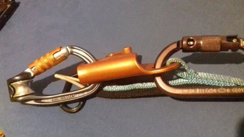

My current home-made knee ascender.
Repurposed left-foot Petzl Pantin. I use a heavier bungee cord than most. Doesn’t need to be very long: I route it through my left side D across to my to my right side D where it is anchored. I get as much lift as the length of the non-rigid footloop/tether allows. I like the foot loop open enough so I can simply flip it off my foot. It has never come off during ascent, the loaded bungee keeps it in place throughout the ascent motion. Stows very compact. Simple may be better in this case.
https://flic.kr/p/2isBugR
Bamboo cam jammer prevents the rope from popping off the rope at the wrong moment:
https://flic.kr/p/2isAkEd
Throwline binding treated with super glue pins the stoppered bungee end down:
https://flic.kr/p/2isBueM
