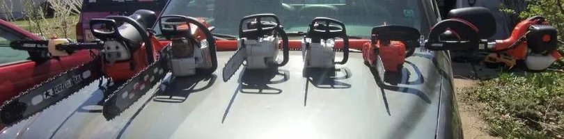

I've only ever owned one Husqvarna saw... years ago. Never was my favorite saw, but it most certainly was not a "piece of shit"... it was a very good saw. I just like the Stihl saws better. And lately, I'm finding that I like most of the Echo saws, too. There are certain Stihl models that you'll never see in my garage. I wouldn't call them shit, but they aren't up to my standards for a work saw. I definitely know what you're talking about, the way people badmouth an entire brand because cousin Bubba had one that broke when he dropped it off the ladder onto concrete, and now all that company's products are suddenly a "piece of shit" henceforth.
[pic is of most recent saw purchases on saw cleaning day]
