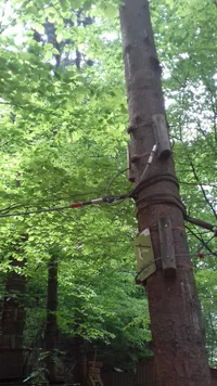

I've seen some zipline operators use blocks in a way similar to what Scratch was showing but with rough-sawn hardwood blocks with the actual cable going around the tree with the blocks in between. I've seen a few others connected to eye bolts through the entire tree.

I have a 150' zipline made from 3/8" steel cable. It goes over a 45' deep ravine on my backyard. Thats why I'm building a rope bridge in another thread. It's about a 150 yard uphill walk to get back to the start. I did a lot of research and found ziplinegear.com to have some very helpful info when it comes to installation, cable stretch, angles, etc. I use their tree saver idea but used 2x4's instead.
I was surprised to hear Climbstihl's info about aerial parks using straps to secure to trees, but then I remembered I used the same method on a trolley system for a moving target setup on my gun range for years, and when I took it down last year, there was no noticeable marks at all on the trees. I may have to switch to that in the future as I think the trees will start to grow around my 2x4 blocks eventually.
Here's my zipline:
