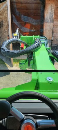

How is the visibility of the grapple on that machine? I drove a buddy's Vermeer 850 (rebranded multione) and I had to hang out of the side of the machine to see what I was grabbing. Far different than the visibility on my Vermeer s600 miniskid.
Attached is a pic I took from the operator's seat. The cylinder to extend the boom really interferes with your line of sight. It's extended in this pic, and visibility is worse when it is retracted. He has a Ryan's grapple with power rotate FWIW.

Visibility is much better in the avant.
Visibility is best on the Giant. With the Giant you sit on the back so you can articulate the front and And have total visibility of the grapple and what you're picking up.
Avants offset boom does help with visibility over the multione/vemeer.

If it’s a dangle power rotator (cannot see from your photo) try and get into the habit of inclining the head down, like a crane.
Then it’s a lot easier.
Having used and owned MO and Avants, The visibility difference due to the offset boom is negligible.
It is, and I often do that on my miniskid. I only ran this one for a few minutes and noticed the visibility issues.
