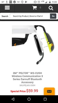

castanea
Member
https://www.envirosafetyproducts.co...ion-x-series-earmuff-bluetooth-accessory.html
This seems promising if the physical button on the muff can activate a walkie-talkie phone app like Zello. A phone is required for it to work at all, but I think Zello can work over bluetooth between phones without a cell signal. Zello has a lot of info on their site about compatibility with third party headset hardware and would probably test it.
Anyway, key points of concern:
-dont think that mic swivels
-one sided audio in muffs
-requires the 3m Peltor muffs
-95F is Max storage temperature, but operates fine at higher temps (?)
-cant tell if battery and ear cushion are replaceable (emailed 3M about these two points and using with an app)
-unsure about noise cancelling, overall quality. I think YouTube reviews (non arborist application) weren't quite glowing. Wouldn't be surprised if you can't be heard while running a saw wide open or standing behind a chipper.
For what is worth I'm not a huge fan of the pads on my 3M Peltor muffs, I prefer to have plugs under them if I'm around the chipper or am running a med or lg saw. I think clamping them on the helmet in storage wears the foam out, which is replaceable.
I don't know why something as simple looking as this isn't available at a reasonable price point without all the fancy media & Bluetooth streaming BS.. just an open intercom that can have infinite units added on, all built into the muff itself with three simple buttons, volume, I/O & Channel.
I haven't looked yet.. but I'd bet there's something affordable over in the airsoft world.. those guys go crazy trying to imitate soldiers exact setups.. I'd wager to bet there some company reproducing modular comms systems at a reasonable cost.. & they would have to be functional to take the abuse of playing army in the woods, even if it is pretend warfare.. "oooooooooh headshot"

"Adapter for the phone jacks"
What you mean by that? I know the picture your posted requires a phone.. but does the next one your referencing require a phone as well?
I want something, side from the Sena stuff, that works completely free of a cell phone.

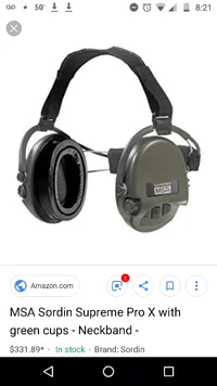

castanea
Member
Sorry, the military headset I got for the range. It has a weird plug to connect to a radio that is bigger than a 3.5mm you see on headphones. The headset I got for shooting used for under $150 on eBay was a MSA Sordin Supreme Pro, here is the style that might work with work helmets. Probably too heavy for climbing I'd imagine but all we really do now is felling.
Here is that plug that would be needed
https://srstactical.com/cell-phone-cable-3-5mm-to-tp120-socket-1302.html
Here is an eBay link, there have been a number of models. I could take mine to work I guess if anyone is interested, could see how well they handle saw and chipper noise. No idea how fast they'd wear out in a work environment.
https://www.ebay.com/ulk/itm/254086881066
Right.. it needs a radio to work as a comm.. that's what i was figuring.. Allot of the military headsets require that, but it's not problematic for soilder systems because they have plenty of space to run equipment off their armor carriers & vests..
I want something completely contained.. like the Sena tuff talk, but for half the cost, none of the silly media features & a usage range that actually works as advertised.
