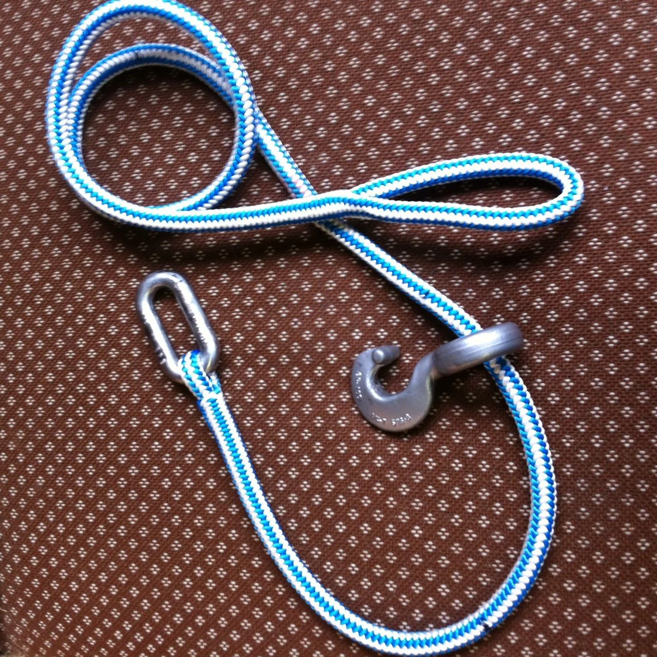

Detachable knotless rigging sling.
robinia
Detachable knotless rigging system. No need to have one end of a rigging rope committed with permanent hardware. Just add or remove whenever you like! Attach to any large spliced eye with 2 girth hitches and a steel ring. Boom.
Hmm, I hadn't considered double braid. Just worked with what I had on hand. I wonder if it's better to use a cover-dependant for this purpose for inspection?
Oroboros, I ordered the hardware from Crosby, through a local supplier. I used the 1/2" end link because I didn't like the way the 5/16 chain coupler fit around a spliced eye. Sharp edges and tight diameter. This link fits perfectly with the 1/4-5/16 chain choker hook, and its got a 6500 lb WLL.

@robinia I know it's WAY late in the game but that does look dope I'm going to have to check online to see if I can source same parts you used, would just get a couple and use TEC so I can always have a fresh sling & save the end of my 5/8 polydyne :D
