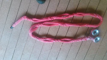

Kind of depends on what you intend to do with it. If I was gonna fork out the cash I would go with this one. http://www.treestuff.com/store/catalog.asp?category_id=455&item=15094
Has two rings on the same end. Can tie it wherever. Don't have to take the rope out of it. Can run a rope through each ring if u need a tag line or are working two spot. Can have super bend radius through both rings or when you have a big rope on big wood. I've negative blocked out of mine.

I just made one out of 5/8 and love it...... I do love me some omni blocks though when I'm not using rings.

I'm straight rings and do everything of them, big or small, negative rigging, posititve riding (hah) whatever. as long as the sling is rated for the weight, let it ride. i use that two ring set up you posted @Raven27 although its one i made. real similar. i use it in collaboration with a single ring sling. then when I'm going to be negative rigging a spar, ill take the double rings and make a 6 coil prussic on the single sling.
CutHighnLetFly
Well-Known Member
If you consider how and where the rope touches the rings when a sling that's only two rings you can see the bend radius is not the same as three. Three rings are ideal, even when talking the largest size, no matter what brand ring.
That being said, before I considered this j was doing everything I do off three rings, off of two with no problems. I just changed the habit instead of pushing my rope
