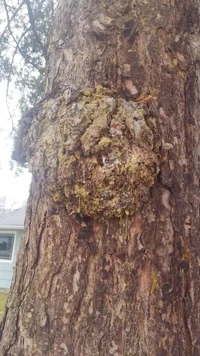

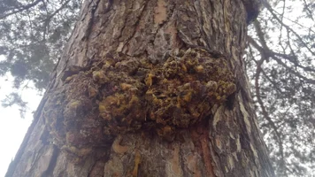

What kinda bug is causing these gall things in pine?
evo
Well-Known Member
Look up pitch moth. I think I see a callus from a pruning wound, which likely attracted the little buggers
JD3000
Most well-known member
2nd.
Zimmerman pine moth damage looks similiar but tends to attack where branches attach.
Philtreeman#1
Active Member
Yeah i think they may have formed around the pruning wounds. The trees are in a very narrow bed along side a gravel drive

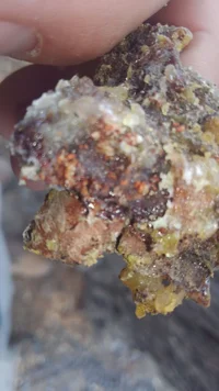

Or is that just a callus that formed over large pruning wound? Definitely looks like some insects involved though because there is some orange frass. Could the insects be secondary? Just not seeing anything on the pitch moths that looks quite like it.
evo
Well-Known Member
I wouldn’t call it a burl per say. Pitch moths typically go for branch collars causing limb failure in some cases. Swollen collars can be signs of some bugs infestations, but I think of it as a ebb and flow of wounding and response growth. Not unlike a target canker where the fungi kills the cambium then the tree starts callusing and then the next year it’s the fungus turn. Depending on the vigor of the tree and the persistence of the organism will determine the outcome

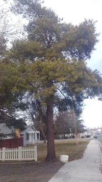

I’ve heard digging the little F’ers out with a knife or poking tool and crushing their heads is the only non chemical alternative. Always best for preventative cultural control. The tree looks a little stressed. What species of pine? And location?
