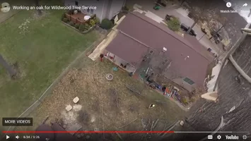

It's so important to analyze every mistake, no matter how minor and learn from it. That's a huge safety factor and one of the best things about video. It allows us to review exactly what happened, often in slow motion. I've watched a lot of your videos and have been mightily impressed at how fast you developed as a climber, faller, rigger. That said, I would invite you to change your attitude. You dismiss your mistakes regularly, losing valuable opportunities to learn and improve.
We all make mistakes. I curse mine and feel so bad about even the little ones, then review them over and over until some way to make sure it doesn't happen again becomes clear.
There was zero reason to tip the limb at 5:24. That monster walnut limb you tip tied in the "near death" video helicoptered around the tree and came 6" away from killing you, 100% DEAD! What did you learn from that? Apparently not!!! If you had but tied the piece at 5:24, it would have swung down and away. There was plenty of room. So why did you tip tie it? That's the question you need to ask yourself if you are going to learn anything here.
It was clearly close enough to scare the other climber. You could hear it in his voice when he called for the goundie to let the piece run. That's a helpless feeling. Then when he was trying to say so in a nice way, rather than apologize and try to learn from it , you just laughed, justified it, and dismissed his concern for safety. While there are no physical consequences to that near miss, there are definitely mental consequences.
It's like a groundie that stands just a little too close to the drop zone. He may in fact be safe, but if the you have to think about it, for even a second before making the cut, it throws your concentration off. Now Brian's fight or flight response has been triggered and he's thinking about you, should he be up there with you?, is he safe? what will you do next?... Perhaps all very subtle thoughts in the back of his mind, but enough to throw off his concentration

Yeah the other climber's look after the tip-tie rattled around a bit said it all. I would've been thinking or more likely saying "Mother f'ker" out loud. Would not work in a tree with the Human after that. Did a tip-tie yesterday on a piece, put the trunk between myself and the rig as a back-up defense in case it didn't go as planned. It went very well, the pivot point in the rig above the piece was just right, groundie nailed it with just the right slight hold then let it run. Not saying I'm a better rigger blah blah only that I'm super cautious and really analyze before committing to the rig. Takedowns are a weird dance of elegance and brutality, ya got to be grounded and calm, and know how to push irrelevant thoughts like "I need to go faster" out of your head. I'm saying that to myself, we're all vulnerable to it.
I listened to an interview with "Free Solo" climber Alex Honnold the other day. He talked about the intense analysis and planning that goes into his climbs, the goal being that when he stands at the base of a wall, he is so confident in knowing what's going to happen next, fear is not present. In that context I think what he's actually saying is that irrelevant and extraneous thought (including inappropriate fear) is not going to enter his mind. This is a possibly underestimated highest level mental discipline, the ability to go into the strongest possible focused state towards accomplishing a task. Something to aspire to for tree climbing and tree work.

I see guys tip tying so far out on limbs or wood all the time and even if it’s beneficial to have the butt fall first it nine times out of ten its better to balance it more by bringing your knot closer to the middle so the piece comes off with more control instead of dropping so forcefully. Gives the ground guy more of an advantage at the porty or Bollard so they don’t have to compensate for the shock load to control the piece on the way down

I have just watched a few of Human's vids. He is very confident, but lacks skill set. Some good cutting at times but some awful cuts also. Trees he is doing look straightforward but he is overthinking. Lots of room IMHO. This guy cut himself out a tree if I remember. Maybe TIP broke. Well he should not be training that guy in a tree he is removing. The gent was not sure on gaffs. And after nearly hitting him laughs. 5 feet miss he says. He scared the dude. Brian should not be in tree period. His voice can be super irritating too. Aw well takes all kinds. Stay safe Human. These mistakes you need to learn from. Slow down and think. Oh he also seems to love cutting through his hinges.

Maybe referring to using a block or x-ring?
I don’t have a problem with natural crotch rigging on a removal generally. Do it all the time. I never rig it like he has it though. I do a quick half hitch below the notch. Keeps the rope aligned with the notch, not wrapped around the blind side of the cut.
TreeCo
Well-Known Member
#17
A half hitch below the notch tied so it does not chase the climber.
The way it was rigged the ground man may have given a slight pull and pulled it right into the saw. There was lots of room for natural rigging.
