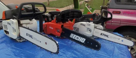

@Benjo75; @JeffGu; You probably both know about this already, but Echo now has a top handle chainsaw that is even lighter than the Stihl 150T. It is the lightest chainsaw available in America, I think.
August Hunicke made a video of his use of the Echo on an actual job; a fun video to watch. If I can find it again I'll post a link to the video later.

It’s a CS 2511T, it’s a half pound lighter and larger displacement. Not sure how they did that. This is his Saw,
it is ported so you won’t get the same experience off the shelf.

The echo 2511 is a great little saw. I had 3 stihl 150’s and they were alright but these echos are more powerful and lighter. It feels like a toy but cuts surprisingly good. A muffler mod makes it even better. I highly recommend the 2511, especially if you have wrist problems.
