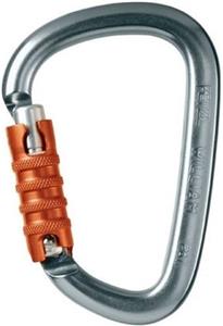

Petzl William?

I run a 3/8th bee line VT on a petl william carabiner. It just seems theres so much scrunching and tryin to get the biner in the holes all while keeping the VT wraps intact when setting up.
Maybe I'm just too fussy. Hence my cat avatar.
