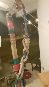

Great idea....squirrel...your are an ity bitty....145...that was my weight at 14...
185lbs.....this will work for any yale 11.7 or any cougar
10mm epi..10mm codeblue...10mm AP....
28"ers
Semn eyes
3/3 VT....last wrap on top always staying on outside of braids.....
swingdude
De' Island Buzzer
Sewn eyes give a soft feel at the legs after the last braid....USUALLY hand spliced are stiff unless tapered to suit ...affect VT's function...
