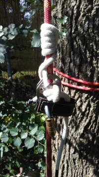

    I made a leather and webbing tending strap, has a metal inserted to keep it's shape.

    That's nice, I made one as well but the part that wraps around the carabiner is metal "old coat hanger"and it doesn't stop it from getting side loaded.

    Leather is a bit tight so it keeps the biner in place.
