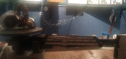

this was an earlier project of jb welding together a bunch of gammon reels. the six footers. I bought a lot of gammon reels lol. they actually make a nice dog leash.
