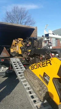

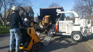

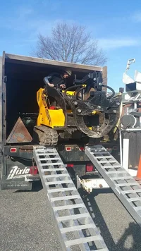

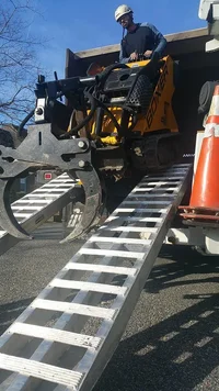

Here's how we are currently set up. These are 10' ramps (discountramps.com) coming off a 42" deck from the back of an F-550. I wish they were longer, but there is a trade-off with weight and storage. The key is to bring the mini out close to the break-over point, then rotate the grapple forward to contact the ramps. Then advance the machine until you get a little weigh on the grapple. At that point, slowly increase (what would be) bucket angle (ie, rotate the grapple backward)--in this way, the machine slowly pivots the front of the tracks onto the ramps. **This prevents the excitement of trying to "ease" over the break-over point using the tracks alone--it is a scary experience--I know first hand!
This setup could be better, but it is what I have at present. BTW, I do not let my workers take this machine off the truck. The advantage is, I show up at a job site with a chip truck, chipper, mini, and stump grinder all in one rig. For all but the biggest jobs, it's been a compact setup that works efficiently for us.
PS. As you can see, we have a small stump grinder. I grind with it attached to the mini just like you see it coming off the truck. Gives all sorts of stability to the machine, and also great ease of maneuverability. Need a bigger grinder, but that's a year or so away.
12804354_10153537562103691_130842655_n.jpg 10299430_10153537561843691_1450284944_n.jpg 12595999_10153537562598691_1762160674_n.jpg 12822814_10153537561708691_1705620711_o.jpg 12842560_10153537562968691_312780799_o.jpg
Note: These ramps are 2500lbs per axle. Also, I beefed up the attachments on the bumper.
