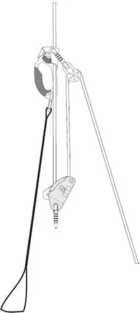

How do you keep the rope from slipping off the pulley? Any way to keep one of the side plates on the outside? Looks like a great idea!
The attachment shows the original RADS setup. Using this modification eliminates gear and makes it easier to switch between ascent and descent. Taking the rope out of the biner/pulley can lead to dropped gear.
Once in a while the rope will jump off the open pulley like Jim uses. I bet it would jump off the washer too. But, in the end, it is an easier setup.
A pear-shaped washer could be fabricated so that there is more material up top to retain the rope. Or, a spring gate could be used...hmmm...would Petzl manufacture this?

Would you find the close proximity of your hand to help keep the rope in the pulley? Like in those rare situations where I've seen it flop out. There's one part of the RADS cycle where the rope changes its direction through the pulley and is a little slack and sometimes pops out if you get overly enthusiastic.
Jim, like I said, I don't believe this will work in every RAD situation. As with most things, it has limitations. The washer does indeed maintain the rope on the pulley pretty well as long as it is not sideloaded too much.
And you are correct, the normal RADS movement needs to be altered slightly. Perhaps a more difficult adjustment for someone who has been using a RADS for a long time, but would be easier for someone just starting out with RADS. I adapted quickly, but was also highly motivated to make it work.
I think the side plate could easily be altered as Tom suggested to create a more secure hookup.

The flop off comes when shifting from stirrup to the device and one slides their hand up, slacking the tail a bit. This area of the RADS is 2:1, so there's more rope streaming through. No biggie. Its just a little indicator that you're not in the max efficiency 'groove'.
I can see where it lines up better, as you've found. I wanted to put the pulley on this point but it lengthens the reach, allowing less rope to ascend per cycle.
