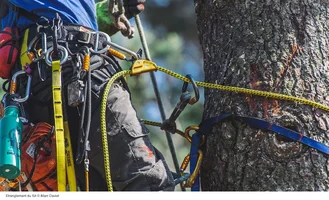

When working on spikes on smaller diameter stems/wood, configure your lanyard in a cinching configuration to prevent sliding down the stem if you gaff out. This can be achieved by simply wrapping your lanyard once around the stem and back to your D-ring, or if you have a thimble prusik installed on your lanyard, clip a carabiner into the thimble, and then connect it to the other leg of your lanyard to "cinch" both sides together closer to the stem.
Another skinny spar positioning tip (Especially if it's a leaning spar): Use your upper D rings for lanyard attachment, instead of forward/lower D rings AND position your lanyard so it's lower on the stem (just above your knees). In this configuration, you are basically pushing up against your lanyard, and down into stem with your legs, and I've found that it provides better balance than any other method. I've also noticed that the farther away from the stem you position, the less comfortable and less balanced I feel. Get up close to the stem, but not too close so you can still operate your saw comfortably. You don't want to be cutting a piece with the chain running 2 inches from your tummy.

What am I looking at with that blue strap and a ring? Like a webbing daisy chain working like a snake anchor?

I missed that the first time I looked. Seconding this request.
I'm not sure what his purpose is for it. Curious as well. I know before I started to incorporate SRT into my climbing system I had spliced up a long whoopie out of 5/16 amsteel that i would use to anchor straight to the bridge like that when I was blocking big wood down. I'd just keep my climbing system clipped in my back to keep it out of the way from chunking down wood.

Could be mistaken, but it looks like this picture was taken during a transition while disconnected from his climbing line. In that case the cinched lanyard becomes primary, and the sling/snake anchor thing becomes a secondary to clip the bridge to using that revolver type biner. Maybe?
It looks to me as if he has that adjustable petzl bridge.. It looks to be something like cool velocity running in a ddrt setup using the revolver. I also could be wrong, however. Seems like a lot of extra crap. Running bowline worth a long tail, rope wrench. Retrievable. If that is indeed what I think it is... It seems cumbersome and a pain in the ass.
