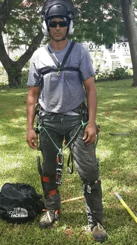

2015....did an arb show in UK where Jo did a SRT exibition. Built this right after with one mod. Elastic on ascender so it would keep knee slightly off rope. Worked better for me. Nice device. 2019-07-09 11.06.15.png
