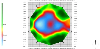

    37# is the record so far. on a shingle oak in Cincinnati. Twice reduced and looking very good. :)
    With all due respect from my almost-alma mater, NCSU's guidelines are very general, like a wild guess, and hard to apply. Yes tomography can give good info. Pulled 19# off a white oak in Raleigh NC. It's also been reduced twice, and tomo'd twice as well. Case Study #1 here; maybe halfway through. http://www.historictreecare.com/wp-admin/post.php?post=1414&action=edit

  8. guymayor
    guymayor Well-Known Member
    Joined:
    Jul 24, 2005
    Messages:
    5,610
    Location:
    East US, Earth
    [​IMG]This tomo image was useful but the pruning specs would not have been too different without it. upload_2017-8-23_7-31-59.png
