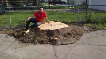

    It all depends what your average tree size your cutting. I'm still a small outfit but have been constantly doing large removals with ugly exposed roots. Iam pretty well setup to complete most big jobs the same day when were out with 3 trucks. My issue i was running into was having my guys end up watching me grind the stump. Thats not fun. It was not uncommon to spend up to 2-3 hrs on large ones where we had to remove the chips as well. Now average grind on decent stumps is 30 mins to an 1hour.. Then u get exceptions, this one was in the middle of the driveway all wood no dirt mound. It was from one end of the fence pole to the next, plus it had to be well below the drive for new gravel base. 20160513_171619.jpg

    16 ft across if u measure the fence poles.

    Wow! Big and ugly for sure! What grinder did you get? And how long did that take? I am running a miller pto stump grinder on my tractor. I have a sanvic wheel on it and do like it. But the whole setup is huge to trailer around. I love having a tractor on the job, to move logs etc, but it takes up a 25 foot trailer and weighs 8500 lbs (not including the 4000lb trailer).
