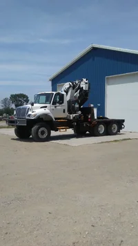

    Well i finally purchased my first crane. It was something I've been pushing off for a while, but just had to finally get. For doing tree work do we need a crane license to legally operate a crane? What type of straps would work best in conjunction with a k-boom? Also what type of liability do u guys carry? Iam new on this side so please bare with me.. 20170630_121559.jpg

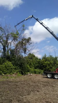

    For now this is what I have...no manual jibs. It is too short for my area, for much other than log picks...unless right up on the tree (and it isn't huge).
    I'm hoping to upgrade it to a 100' side reach in a year or 2. I made sure the truck was big enough to be able to fit a larger crane on it. Freightliner fl112 with 20k front axle, and a tag axle (that I'll change to a pusher then) 73k gvw currently. Fassi 270a crane with 1,852 lbs at max 59' side reach (72' vertical) [​IMG]

    That's what I'm looking for, thanks. I have a effer 370 97' vertical with the last one being a manual pull out

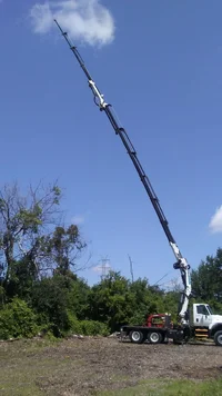

    Good deal, I have the Mecanil SG280 for mine... in the pano picture I posted (click on it to make it bigger). Also in the picture you can see the side of the jib, the aluminum box with hoses is the splitter valve you mentioned that splits the elevation/extension circuits into rotation/grapple circuits. The fluid travels from the box to the hose reel, the hose reel has 4 hoses that run to the tip of the jib.
    If I have a Mec built for me, I will look heavily into having two extra circuits added for the grapple saw vs splitting functions. It may be impractical/expensive to some, but I would like it. That would replace the hose trays on the outer boom with two hose reels, one for the jib (elevation/extension) and one for the grapple (open/close and rotation).
