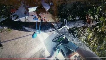

    So Corey better known as Human on YouTube took a fall last week. His tie in point broke up high in a large oak and he plummeted 25' or so straight to the ground and broke his pelvis and suffered an L5 injury. He was climbing SRT with a base anchor and had claimed he tested his tie in point beigre climbing.
    Very eye opening experience for all of us out here. Goes to show how important insurance and safety is . I wish him a speedy recovery. Check out the video, there's many thugs that can be learned from what happened.

    Any idea if the anchor point was too small, or was there a defect in the tree that caused the breakage?

    In the video he said the tree needed some major pruning work so it's possible since it was such a dense canopy he couldn't see he was in a bad crotch

    He said at some point in the video he should have just set his anchor lower and then reset it higher after entering the tree, which I agree with.
    He appeared to be base tied as well.
    So theoretically doubling his weight on an PSP he couldn't see in a tree full of dead wood.
    This is definitely a reminder that we need to remain humble and play the game following the rules dictated by each tree.
    Not trying to bash the dude, I fell 20 feet a few months ago in a similar situation. Thankfully I walked away unscathed, but I learned my lesson.
    I never base tie through small stuff in the canopy and really try to avoid base tieing all together. Taking the extra time to isolate and be sure of your PSP is worth it every time.

    After my fall in a similar situation I am very careful about my TIP. I take the time to inspect it to assure myself that it's solid. Oft times, I do start with a lower point that I can see and then advance it as I go. Sure it takes time but when compared to the lost time due to the injury it's much more cost effective.
    What I wondered to myself was why he wouldn't have used the bucket to set himself in the tree?
