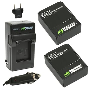

Thank you, Will. I'll be trying to post more vid as I can. This was a crazy year in so many ways, and I'm hoping to have more time to record and post fun stuff I encounter. Step one...figure out how to make the GoPro battery last 4 times as long as it does now. I'd use it so much more if it did.
This won't help with having to change over to another battery but this is the deal right here:
http://www.amazon.com/Wasabi-Power-AHDBT-201-AHDBT-301-AHDBT-302/dp/B00AAIPT76
I got a set, and I sent one over to swingdude in Barbados. Comes with a wall charger and I always seem to have an extra batt on standby now.

Yes, you can't carry to many batteries and I second the Wasabi powerpack chargers, two at a time helps and you can plug into the car too.
Thanks, Richard. I'm looking into those units today. I figured the GoPro was a sealed unit with more planned obsolescence than a tissue. GoPro...GoFigure. ;) I actually love the camera. It's really well thought out as far as user features and there's something special about the image.
