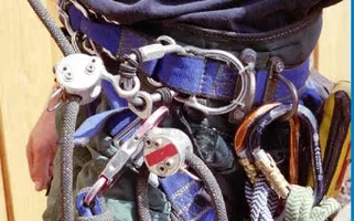

Here is the DEDA setup that I use with positioners. I moved the d-ring back and slipped in a square MR link to keep things tight and tidy. I still have some work to do. My plan is to add some tubing to keep the Positioners in place.
Tom

Is there a way you could perhaps use steel-shaft stoppers
like this one, see attached image. To keep the spacing
between the positioners that is. There might be models
with more screws, to get an equal grip.

In order for that to clear the corner radius in the MR the inner diameter has to be large. Then, the only support is from the set screw. I think that it might tip or slide. ]
What I might do is look for a two piece collar or maybe just us split a piece of tubing and then secure it with constrictor hitches. I have some small Spectra throwline that would work to hold the tubing in place.
Tom
