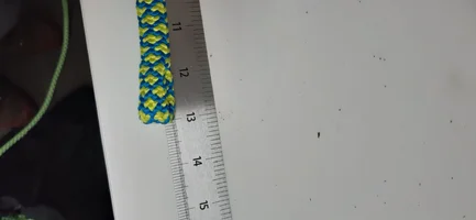

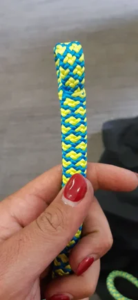

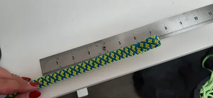

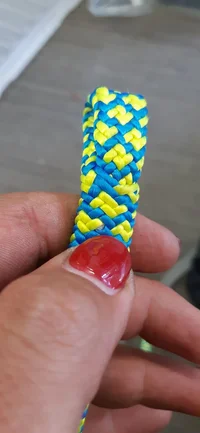

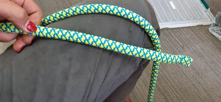

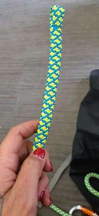

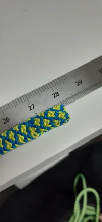

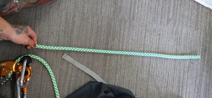

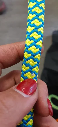

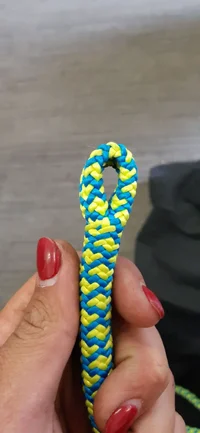

So theres a lump at 28 and 13 inches and the wipping ends shown near the eye and at 7 inches. The undulations continue past the whipping. For abput 5 inches20191011_153532.jpg20191011_153504.jpg20191011_153553.jpg20191011_153851.jpg20191011_153811.jpg20191011_153908.jpg20191011_153428.jpg20191011_153424.jpg20191011_153452.jpg20191011_153450.jpg

Thanks for the pictures, I’m wondering if that is whipping twine or maybe a core strand. Are there more than one end showing at the two locations?
It's definitely whipping twine thats been melted a little. These are the only ends ive been able to find.
