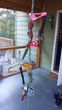

The CMI glide pulley can be made into a rope wrench with the addition of a rope wrench slic pin.
http://www.treestuff.com/store/catalog.asp?item=763
You just have to move the sheave and add a tether with some accessory cordage and creative problem solving. Mine is on the bottom shown with a zk2.
Easing into srt is probably going to involve switching over to drt once you get up there so you can stay comfy climbing with familiar technique. So really you can start with all the old stuff just different techniques.

All this talk about ascenders and bungees and pulleys and chesties and special rope is not really beginner talk. The foot ascender is really the most expeansive thing you are going to want.
Hitches can be tied with longer pieces of cord in order to produce enough friction to work on a single line, but that is experimental. The munter can be used for descending srt in combo with a normal hitch.
Rope-a-dope, I would question both those set ups. On the wrench, it does not appear as if there is enough distance between to top of the knot and the bottom of the wrench to prevent conflict . Will the wrench flop past horizontal on that tether? If so, you are exaggerating the issue.
On the lower set up the pulley is not fit for purpose at all. That short tether looks like it will act as a reverse slack tender. Or what we call here a hitch hammer.
Perhaps I am mistaken, but they both appear to be "funny" at first glance

Yea Tony they are funny! I made both tethers to be as short as possible without interfering with the hitch. The wrench engages right above the top coil as descent begins and disengages without sitting on the hitch. I tested them both a lot and like the wrench to be that close so that when going out sideways I can grab the wrench and "hammer" the hitch down to prevent the wrench from adding too much friction.
You're right about the pulley. Unintended usage caveat should come first. But it works beautifully and it has been said before about the many iterations of wrenches: their purpose is merely to add friction as the hitch is responsible for fall protection. Not life rated is the short phrase!
Fair enough. A 2" distance is preferable and highly recommended as distance between hitch and wrench. Be careful. A properly adjusted system is crucial for all climbing systems from tauntline MRS to Rope Wrench SRS. The recommendations alow us to learn from others' mistakes as opposed to our own.
I understand the point that the wrench is not life support. However, expecting the best and planning for the worst will never fail you. Also don't assume that the wrench and hitch split the load 50/50. Many variables and it is rarely the case. My informal testing shoed me the hitch can in fact be secondary to the friction device above.
I am all for DIY, but when it comes to climbing gear we depend on for life support, compromising safety and reliability for $$ is making a hazardous activity dangerous.
