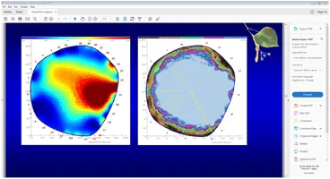

How does one calculate via that a tree is "far too dangerous to remain standing"?
That sounds oxymoronic--unless the tree is laying down, it is able to remain standing. This "Keep or Kill" paradigm is hard to understand. Who do we think we are? "What are reasonable mitigation actions" might be a more helpful paradigm. We need to help the tree owner decide, not decide for them.
Here's a tomogram of a tree that was managed by pruning. Is there legit science that says it "needs to come down"??NE Hollow.png
