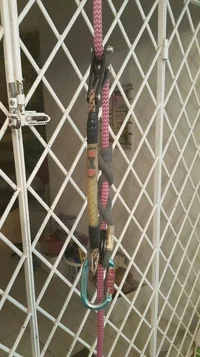

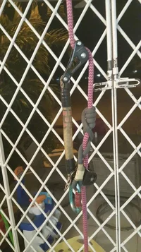

Pictures of my rw setup are attached.
Any thoughts are appreciated.

One thing that might make a considerable improvement is a slightly shorter hitch with sewn eyes. The overal hitch often ends up being more responsive, with less sit back.
I would recommend you order a 28" 10mm EpiCORD with sewn eyes and give it a whirl in a Michoacan config on that cougar.
Rain can make cordage swell a bit and feel quite different. In time you'll most likely either get used to what's inherent with those conditions, and make proactive changes, or just avoid the conditions all together.
Sometimes I like the rain and where it brings me. It's like nightfall, when so many others are staying inside. It can feel sort of tranquil.
Ditch the extra biner on the tether..connect tether between one eye and hitchclimber....also my vote is a 28" epi 10mm with a 3/3 VT....

Hey, Swingdude, thanks for your input. To follow up explicitly on "connect tether between one eye and hitchclimber", 1.) does the "one eye" fit as most tethers directly on the rw (as mine is in my picture), and 2.) what is the most compact, safe, preferred connection method between the tether and the hitchclimber pulley? I've seen so many tethers and tether widgets by now that it's getting a little crowded in my head, lol.

Here ya go.....pics tell a million..that setup is mint2016-05-10 20.55.40.jpg2016-05-10 20.55.08.jpg
